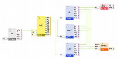

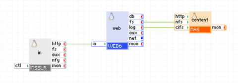

To provide http(s) access to your application, connect the http terminal directly to the WEB appliance.
If you need a scalable web application hook the http terminal to a HALB appliance.

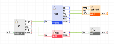

Web Applications with Additional Services
If you have more services than just http in your application, you can use INSSLR to pass http traffic to its http terminal and use the aux terminal for other services.
Property
Value
Notes
l7_accept
http/https/both
Specifies what l7 protocol is used. NOTE: if https or both is specified, the key volume should contain the ssl certificate as specified by the cert_file property
l3_accept_proto
tcp
Redirect tcp ports 25,110,143 to aux terminal.
l3_accept_port
25,110,143

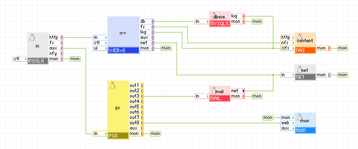

Web Applications with More than One Additional Services
If you have multiple tcp/udp services and http, you can use INSSLR to pass http traffic to its http terminal and use the aux to feed the rest of the traffic to PS8, which feeds the desired traffic to the back end servers.
Using INSSLR to pass http traffic to its http terminal and using the aux to feed the rest of the traffic to PS8
Property
Value
Notes
l7_accept
http/https/both
Specifies what l7 protocol is used. Note: if https or both is specified, the key volume should contain the ssl certificate as specified by the cert_file property
l3_accept_proto
all
Redirect to aux terminal all IP (except icmp) traffic that is not passed to the http terminal.

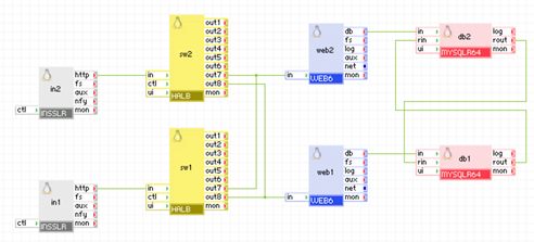

Redundant Web application (single application)
If you want to have your application run in redundant mode without creating a new application, you can simply double the appliances in it and run them in redundant mode. Because this involves using (at least) two web servers and two database appliances, in normal mode they are all used (providing scalability), but each of them is able to serve the application alone in case the other appliance fails. If you need additional scalability you can add more web and database appliances. In this example half of the appliances (in1, sw1, web1, db1) are running in one failover group and the rest (in2, sw2, web2, db2) are in another failover group so that the application can survive a server crash. This application provides redundancy at a very low cost as all of the appliances (except for one INSSLR and one HALB appliance which require very low resources) are in active state and no resources are spent for a backup application that runs only when the primary fails.
in1
Property
Value
Notes
ip_addr
1.2.3.4
Public IP address of the application, must be the same for the primary and backup application.
netmask
255.255.255.0
Netmask for the public IP address of the application, must be the same for the primary and backup application.
gateway
1.2.3.254
Gateway for the public IP address of the application, must be the same for the primary and backup application.
fover_mode
symmetric
Run in symmetric mode.
fover_local_ip
192.168.100.1
Private IP address to be used for communication between INSSLR appliances in the two applications.
fover_remote_ip
192.168.100.2
Remote IP address to be used for communication between INSSLR appliances in the two applications.
fover_netmask
255.255.255.0
Netmask for fover_local_ip.
in2
Property
Value
Notes
ip_addr
1.2.3.4
netmask
255.255.255.0
gateway
1.2.3.254
fover_mode
symmetric
fover_local_ip
192.168.100.2
fover_remote_ip
192.168.100.1
fover_netmask
255.255.255.0

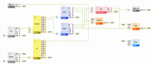

Redundant Web application (two identical applications)
You can run two identical applications on the same grid (but on separate servers so that failure of a server can only affect one of the application), or on different grids, provided that the IP address you use is accessible from both grids. The example below shows an application that uses a database appliance which is also running in redundant mode so in case of failure of one application, the other application can take over without data loss.
Appliances in use:
Client request arrive on the in1 gateway. The gateway forwards the requests to the web_lb load balancer, which directs the request to one of the web servers web1 and web2. The web servers access the db database. The db appliance connects to the remote application (which is an identical copy, the only difference being the server_id of db and the network setup) to replicate the database. The remote application connects to the db appliance via the repl_in gateway which is configured to allow connection only from the repl_out gateway of the remote application. The db appliances in the two applications are running in master-master setup so they always have identical data.
Example property configuration (properties that are not listed should be left to their default values):
Web access to db is available using admin gateway on port 8080.
in1
Property
Value
Notes
ip_addr
1.2.3.4
Public IP address of the application, must be the same for both applications.
netmask
255.255.255.0
Netmask for the public IP address of the application, must be the same for both applications.
gateway
1.2.3.254
Gateway for the public IP address of the application, must be the same for both applications.
fover_mode
symmetric
fover_local_ip
192.168.100.1
Private IP address to be used for communication between INSSLR appliances in the two applications. Change this to 192.168.100.2 on the remote application.
fover_remote_ip
192.168.100.2
Remote IP address to be used for communication between INSSLR appliances in the two applications. Change this to 192.168.100.1 on the remote application.
fover_netmask
255.255.255.0
db
Property name
Value
Notes
auto_create
1
Create the database if the volumes are empty.
error_log_filename
db.error
Name of error log file that is to be stored on the logs data volume.
error_log_level
error
Error logging level
server_id
1
Master server 1, this should be different on the second application
rpl_mode
master_and_slave
master and slave
Important! Only one of the applications is active at any time, the other one is running simply for failover and is used when the active application fails.
