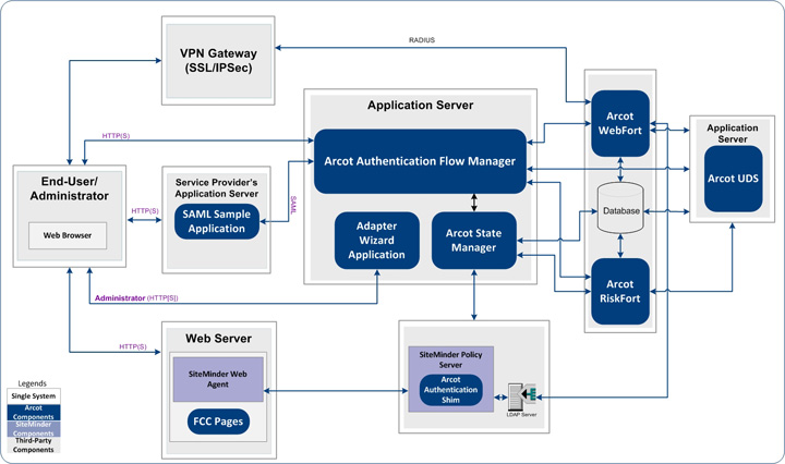

The following figure depicts a possible deployment option for prerequisite software and Adapter components.
Install and deploy Adapter components as depicted in this figure. Also, it is recommended that you use a secured communication channel between all Adapter components. For more information about configuring SSL communication, see "Configuring SSL in Apache Tomcat".
