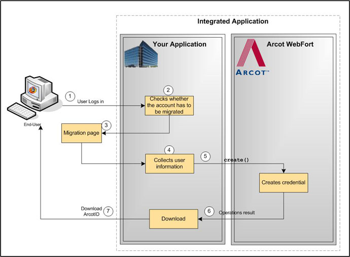

The typical steps to migrate selected users are:
The users log in to your application by using your existing authentication method.
Application retrieves user information and identifies whether the user account is marked for migration.
Upon successful authentication, the user is redirected to migration page.
Your application can either display the appropriate pages to the user. For example, you can prompt the user to set the password for ArcotID PKI or you can set the existing password as the ArcotID PKI password, and collect questions and answers if QnA is used for secondary authentication.
Your application invokes the create() method in the CredentialIssuance interface to create ArcotID PKI for the user.
If the create operation was successful, then user’s ArcotID PKI is returned.
If the create() function was successful, then the application downloads the ArcotID PKI to the enduser’s system without any user interaction.
The following figure illustrates the workflow for migrating the users to ArcotID PKI authentication in bulk:
