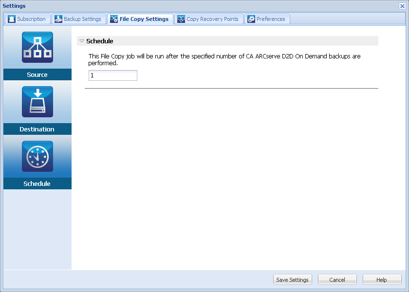

  1. From the CA ARCserve D2D On Demand home page (or CA ARCserve D2D On Demand Monitor), select Settings from the taskbar and then select the File Copy Settings tab. When the File Copy Settings dialog opens, select Schedule.
    The File Copy Settings Schedule dialog opens.
    File Copy Settings - Schedule Dialog
  2. Specify your File Copy schedule settings.
    Schedule
    Enables the file copying of data after the specified number of backups.
    The file copy process will be launched automatically after the specified number of successful backups (Full, Incremental, and Verify) and will be based on your selected File Copy policies.
    You can use this setting to control how many times a File Copy job is triggered each day. For example, if you specify to run a backup job every 15 minutes, then if you specify to run a File Copy job after every 4 backups, there will be 24 File Copy jobs performed each day (1 each hour).
    The number of backups that can be specified before the File Copy job runs must be in the range 1 - 700. By default, the schedule for file copying is after every five successful backups are completed.
