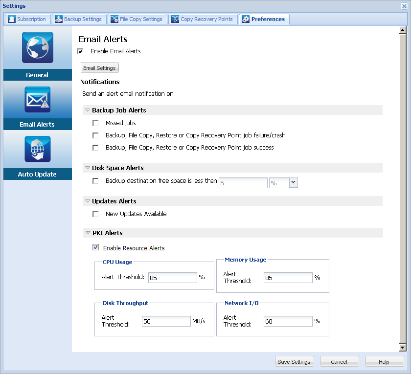

  1. From the CA ARCserve D2D On Demand home page (or CA ARCserve D2D On Demand Monitor), select Settings from the taskbar and then select the Preferences tab. When the Preferences dialog opens, select Email Alerts.
    The Email Alerts preferences dialog opens.
    Preferences Settings - Email Alerts Dialog
  2. Specify your Email Alerts notification settings.
    Automatic email alert notifications are sent upon the completion of selected events. You can select any or all of the available options.
    Note: If you do not need specific notifications for successful jobs, you can configure CA ARCserve D2D On Demand to only send email alerts for failed and missed jobs. This configuration could help you reduce the amount of email notifications and also monitor any failures.
    The available options are to send an alert notification for the following events:

  3. Click Save Settings.
    Your Email Alerts preference settings are saved.
  4. After you select to send an email notification, you can then click Email Settings to display the related dialog.
