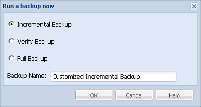

Run a backup now
  1. From the CA ARCserve D2D On Demand home page (or CA ARCserve D2D On Demand Monitor), click Backup Now.
    The Run a backup now dialog opens.
    Backup Now
  2. Select the type of backup you want to perform.
    The available options are Full, Incremental, or Verify.
    Full Backup
    Initiates a Full Backup of your entire machine or the selected volumes.
    Incremental Backup
    Initiates an Incremental Backup of your machine. An Incremental Backup backs up only those blocks that have changed since the previous backup.
    The advantages of Incremental Backups are that it is a fast backup and it produces a small backup image. This is the most optimal way to perform backups.
    Verify Backup
    Initiates a Verify Backup of your machine by examining the most recent backup of each individual block and comparing the content and information to the original source. This comparison verifies that the latest backed up blocks represent the corresponding information at the source. If the backup image for any block does not match the source, CA ARCserve D2D On Demand refreshes (resynchronizes) the backup of the block that does not match.
    Advantages: A very small backup image is produced when compared to a Full Backup because only the changed blocks (blocks that do not match the last backup) are backed up.
    Disadvantages: The backup time is slow because all of source disk blocks are compared with the blocks of the last backup..
    Note: If you add a new volume to the backup source, the newly added volume is fully backed up regardless of the overall backup method selected.
  3. If necessary, specify a backup name and click OK. If no backup name is specified, it is automatically named Customized Full/Incremental/Verify Backup by default.
    A confirmation screen appears, and the selected type of backup is launched immediately.
    All configuration settings specified in the Backup Settings dialogs are applied to the job.
    Note: Only one job can be run at a time. If you attempt to manually launch a backup job now and another job is currently running, an alert message informs you that another job is running and request that you try again at a later time.
    Note: If a custom (ad-hoc) backup job fails, no makeup job is created. A makeup job is only created for a failed scheduled job.
