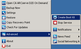

  1. From the CA ARCserve D2D On Demand Monitor, click the Advanced option and then select Create Boot Kit.
    The CA ARCserve D2D On Demand Boot Kit wizard is launched and the Welcome screen opens.

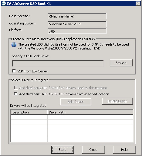

    The CA ARCserve D2D On Demand Boot Kit dialog opens.
    Boot Kit Dialog - USB
  3. Specify or browse to the location for the installed USB stick.
    If you do not have a USB stick available or you do not want to create the boot image on a USB stick at this time, you can save the boot kit data temporarily to another location and then copy it to a USB stick later.
  4. If necessary, select the driver integration option.
    The selected drivers are then loaded during the recovery process.
  5. Click Start.
    The Boot Kit creation progress is displayed and a confirmation message is displayed when the USB stick has been successfully created.

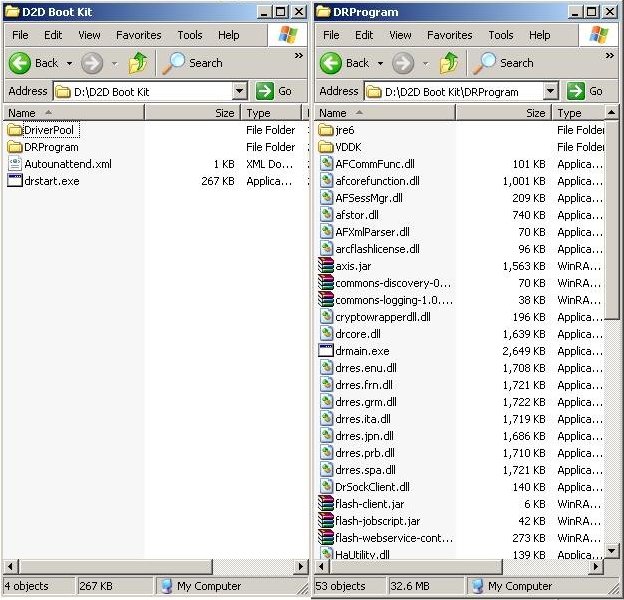

  6. After the successful creation of the Boot Kit, you can find the CA ARCserve D2D On Demand Boot Kit files on your USB stick.

    Boot Kit Creation Output
