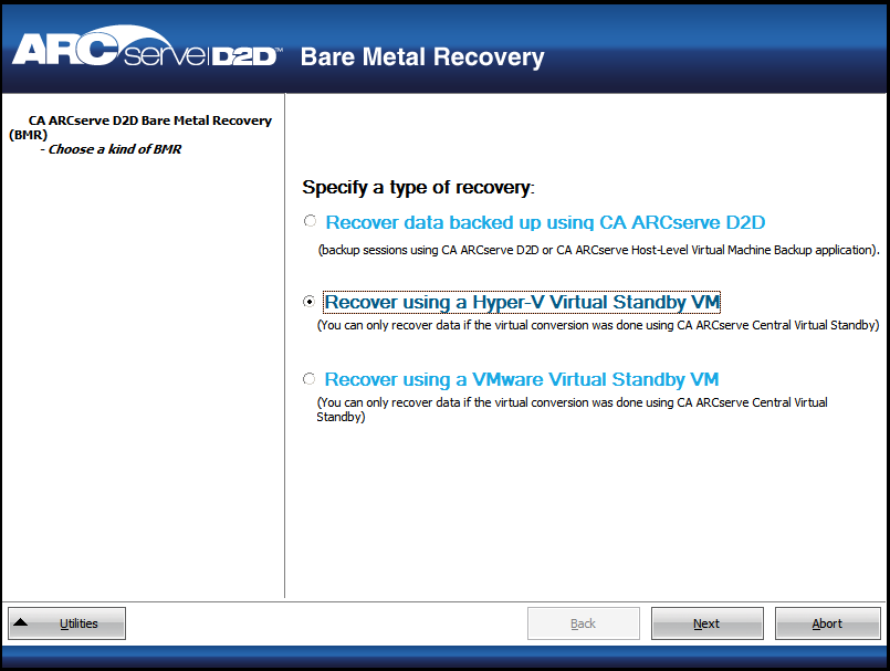

After you select the "Recover using a Hyper-V Virtual Standby VM" option, perform the following steps before returning to the Bare Metal Recovery procedure to complete the process.

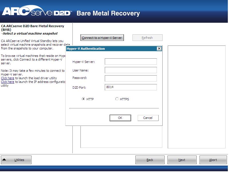

The Select a virtual machine snapshot screen is displayed, with the Hyper-V Authentication dialog, prompting you for Hyper-v server details.

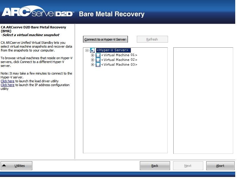

CA ARCserve D2D detects and displays the Hyper-V Server with a listing of all the virtual machines that are converted to the specified Hyper-V server using CA ARCserve Central Virtual Standby.

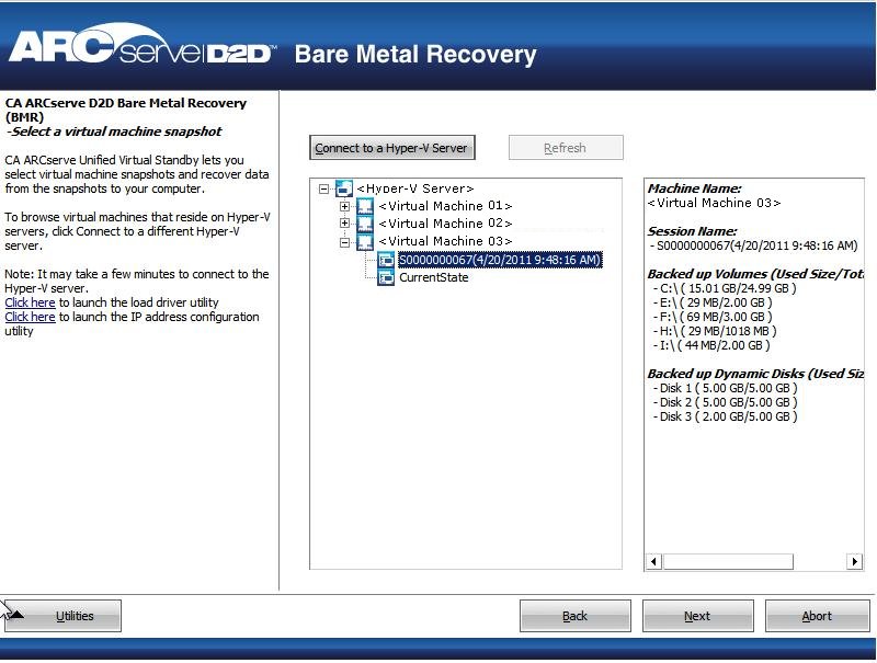

The backup sessions (recovery point snapshots) for the selected virtual machine are displayed.
The corresponding details for the selected recovery point snapshot (virtual machine name, backup session name, backed up volumes) are displayed in the right pane.
In addition to selecting one of the listed recovery points, you also have the option to select the "Current State" or the "Latest State" recovery point.
If you select the "Latest State" recovery point, an error message is displayed to inform you that the recovery point you are recovering from is the Latest (and not the Current) state and requesting that you start the virtual machine before continuing with the recovery process.
