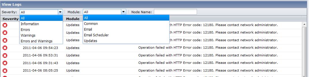

The View Logs screen appears.
Note: This field supports the wildcard '*' and '?'. For example, enter 'lod*' to return all activity logs for the machine name that begins with 'lod'.
Note: The Severity, Module, and Node Name options can be applied collectively. For example, you can view Errors (severity) that relate to Updates (Module) for Node X (Node Name).
Click Refresh. ![]()
The logs display based on the view options specified.
Note: The displayed Time in the log is based on the current time zone where the CA ARCserve Central Protection Manager application resides.
