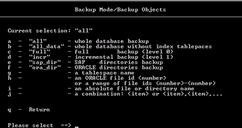

- Enter d—Objects for backup.
The Backup Mode/Backup Objects screen opens.
- After you select an object for backup, enter q to return to the Back up database screen.
