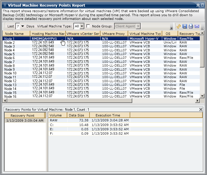

The Virtual Machine Recovery Point Report can be further expanded to display more detailed information. You can click a row to drill down from a report of summary information to a more focused and detailed report about that particular recovery point.
The drill down view is made up of two tables: Recovery Point and Volume.
The Recovery Point table displays all recovery points available for the virtual machine selected and lists the dates/times of the recovery points.
The Volume table displays all the volumes that were backed up as part of the selected recovery point.
