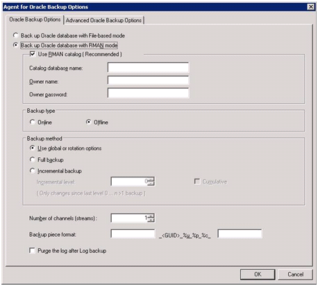

- To set backup options, select the Source tab, and then right-click to select Local Options.
The Agent for Oracle Backup Options dialog opens.
- Select the Back up Oracle database with RMAN mode option to enable the fields.
- Complete the following fields:
- Use RMAN catalog (Recommended)--Ensure the Use RMAN catalog (Recommended) is selected and enter the catalog database name and owner password.
Note: You can use the RMAN catalog, otherwise RMAN will rely only on the control files to manage backups. Using only the control files presents a risk in that if the database and all control files are somehow lost, it will prevent RMAN from being able to restore the database. By using the RMAN catalog option, you prevent the possibility of losing the control files backup-related information and other valuable information. Also ensure that if you do not use the RMAN catalog, you limit the possibility of performing a point-in-time recovery.
If you choose not to select the catalog database option, a warning message displays reminding you that the Agent for Oracle cannot perform a full database backup or restore using RMAN.
- Backup Type--Select the offline mode.
- Backup method--Lets you specify one of the following backup methods:
- Use global or rotation option--This option is enabled by default. If you do not disable this, backup job will use the global or rotation backup method on the Schedule tab.
- Full Backup--This method typically minimizes the number of tapes you will need when restoring the database, but takes more time during the backup.
- Incremental Backup--This method reduces the backup time, but restoring typically requires more time and tapes to be loaded (that is, the last full backup plus all the incremental ones).
- Number of Channels (Streams)--If you have more than one drive and volume in your system, you can use the Number of Channels (Streams) option on the Backup Manager to enhance the performance of your backups. After you allocate a certain number of channels to be used for the backup, the agent and RMAN determine how the multiple channels are organized and distributed, and whether all the channels you specified are necessary. In some cases, RMAN may determine that instead of using all the channels you specified, the backup job could be better accomplished by sequentially packaging more than one job (backup piece) per channel, and as a result will use a smaller number of channels for the job. The number of devices or device groups available on your system dictates the number of jobs RMAN runs simultaneously.
Important! After specifying more than one channel in the Backup Manager, avoid selecting a specific media or media device group on the Destination tab as this prevents multistreaming from occurring.
Note: In the Oracle Backup Options dialog, ensure that the value in the Number of Channels (Streams) option is between 1 and 255. As this parameter affects the Agent, RMAN determines the actual number of channels (streams) needed for the backup and restore job.
- Backup Pieces Format--Enter the prefix and suffix of backup pieces format string.
- Purge Log After Log Backup--Use this option to purge the Archivelog after they are backed up.
