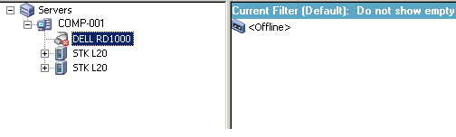

The removable drive is now in an offline state in the Device Manager window.
Note: After you mark the removable drive as offline, <Offline> displays in the Device Manager window.
