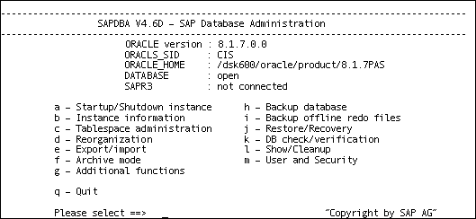

To back up online databases using SAPDBA and BRBACKUP
The SAP Database Administration screen displays.

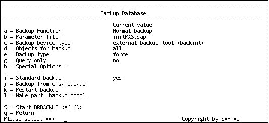

The Backup Database screen displays.

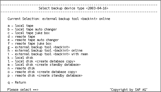

The Select backup device type screen displays.
