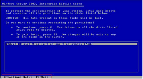

The ASR process evaluates the available disk configuration. If ASR requires you to recreate disk partitions, a recovery process dialog opens.
This dialog does not appear if you are not recreating disk partitions.
