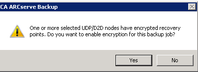

    Note: If the Arcserve UDP sessions is protected by Arcserve UDP session password, then the following message appears to let you enable the Arcserve Backup encryption.
    ASBU Encryption
    The Security and Agent Information dialog opens.
  7. On the Security and Agent Information dialog, edit or confirm the security and agent information for your job, and click OK.
