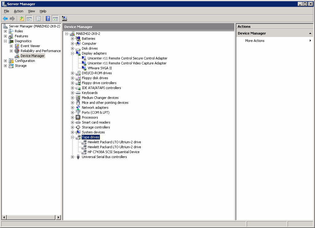

- Verify that Windows detects your hardware by accessing Computer Management Console and selecting Device Manager.
The following graphic illustrates a sample Device Manager view:
The library should be listed under Medium Changers and the Drives are usually listed under Tape drives. If there are no available Windows drivers for the Tape drives, they will be listed under Other devices. CA ARCserve Backup does not require device specific Windows drivers.

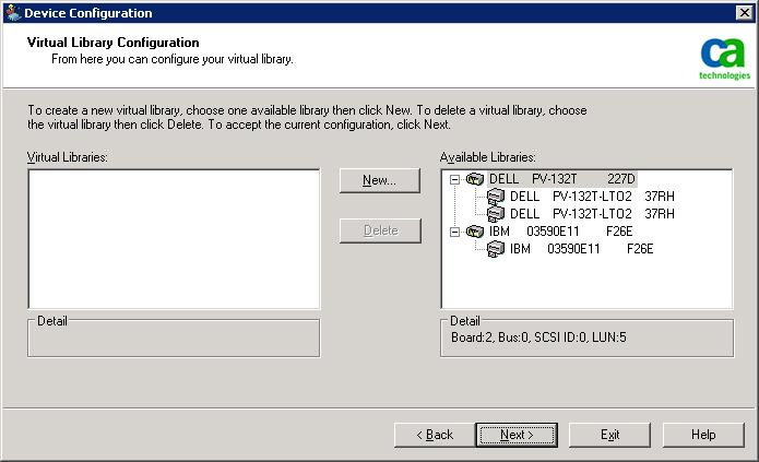

- From the Administration menu in the Navigation Bar on the CA ARCserve Backup Manager Console, select Device Configuration.
The Device Configuration Welcome dialog opens.
- Select Virtual Library and click Next.

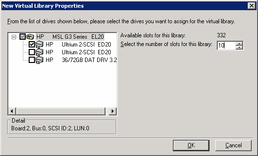

- Select the library from the Available Libraries list that you want to divide into CA ARCserve Backup virtual libraries and click New.
The New Virtual Library Properties dialog opens.
- Select the drive or drives and the slot range that you would like to assign to the drive and click OK.
You have successfully created a CA ARCserve Backup virtual library.
- Repeat Steps 5 and 6 to configure as many CA ARCserve Backup virtual libraries and drives as necessary for your library.
- Click Next.
You have successfully saved your CA ARCserve Backup virtual library configuration.
