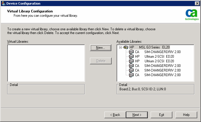

To configure mixed media, CA ARCserve Backup virtual libraries
The Device Configuration Welcome dialog opens.
Note: If the Tape Engine is currently running, you are asked to stop it. Click Yes to continue.

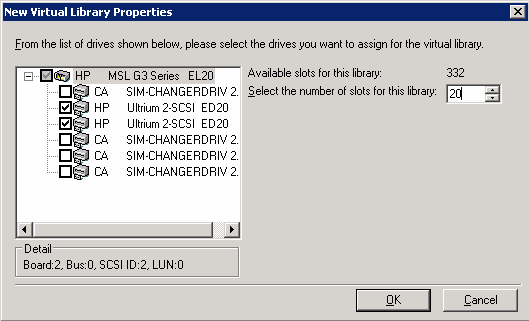

Note: The slot range specified is in sequential order, beginning with the first slot in the library. Make sure that you select the drives having the same media type as the media in the first slot range.

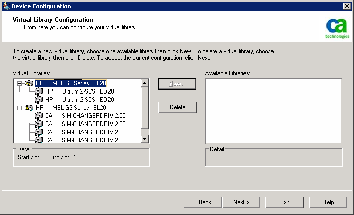

You have successfully configured a mixed media, CA ARCserve Backup virtual library.
Note: If your hardware configuration changes, you must reconfigure your CA ARCserve Backup virtual libraries for CA ARCserve Backup to work properly. If you must disconnect a library that was configured into CA ARCserve Backup virtual libraries, you should delete the CA ARCserve Backup virtual libraries before disconnecting.
