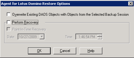

Lotus Domino Restore Options
The restore options for CA ARCserve Backup Agent for Lotus Domino are displayed in the Agent for Lotus Domino Restore Options dialog. To access this dialog, select the Lotus Domino server, right click, and select Agent Options.
Illustrating the Agent for Lotus Domino Restore Options window

The available options are:
Overwrite Existing DAOS Objects with Objects from the Selected Backup Session
Overwrites the DAOS object with the object in the selected backup session.
Note: If you do not select this option, CA ARCserve Backup skips restoring the DAOS object.
Perform Recovery
Recovers the database up to the current date and time (latest recovery).
Point-in-Time Recovery
Recovers the database up to the specified point in time (date and time).
Note: Recovery is the process of applying database changes that occurred after the database was backed up. The recovery process returns the database to a more recent state. Point-in-time recovery gives you further flexibility by allowing you to bring the state of the database to a particular point in time.
