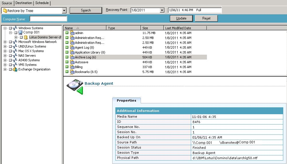

  2. From the Source tab drop-down list, select the restore method.
    The options displayed in the corresponding source tree depend upon whether you select the Restore by Tree method or the Restore by Session method.

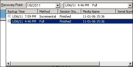

  3. To restore a different backup job other than the most recent, click the server name, and then click the first Recovery Point drop-down control and select a recovery point day.
  4. Click the second Recovery Point drop-down control to view all available sessions and select the appropriate session.
    Illustration showing the Version History dialog
  5. In the Source tab, locate the Lotus Domino database that you want to restore.
    Note: If the Lotus Domino archived transaction logging option was enabled during the backup, the Transaction Log icon will be the first object displayed on the expanded Lotus Domino server tree. However, if no log files were previously archived, the Transaction Log icon will not be displayed at all.
  6. Select the object to be restored by clicking the corresponding marker until it is solid green (full restore).
    If the Restore By Session method was selected, the entire Lotus Domino server can be restored as a whole by clicking the corresponding marker next to the server name until it is green. To restore individual database files or transaction log files, you must select them individually by clicking the corresponding marker until it is green.

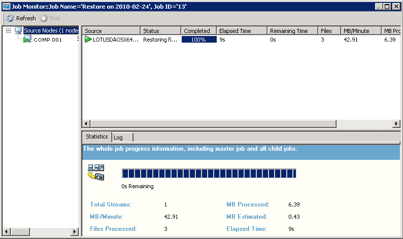

    The Job Status window appears, displaying the Job Queue and Job Detail. You can also view more detailed Job Properties information by right-clicking the server name and selecting Properties. The Job Monitor window appears, displaying details and status of the restore process.
    Illustration showing the Job Status dialog
    When the restore job is complete, a status window appears, indicating the final status (successful of failed) of the restore job.
