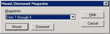

  1. Click the Mount toolbar button.
    The Mount/Dismount Magazine dialog opens.
    Mount/Dismount dialog. Slots 0 through 4 is specified.
  2. From the Magazines drop-down list, select the magazine you want to mount or dismount.
    Depending on the operation that you want to perform, click one of the following:
    CA ARCserve Backup mounts or dismounts the magazine.
