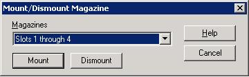

To mount and dismount a magazine
The Mount/Dismount Magazine dialog opens.
Depending on the operation that you want to perform, click one of the following:
CA ARCserve Backup mounts or dismounts the magazine.
