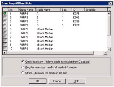

To inventory slots
The Inventory/Offline Slots dialog opens.
Note: You can also click and drag the light icon to select multiple contiguous media.
Note: This method is also known as a Manual Inventory.
CA ARCserve Backup inventories the slots.
