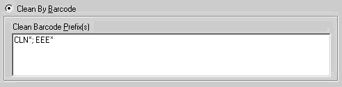

  3. Click the Cleaning tab.
    Modify the following Cleaning options as required for your library:
    Library Options dialog: Clean by Barcode field.
    Note: The asterisk is a wildcard character.
    Click OK.
    The cleaning slots are set based on their bar code prefix.
