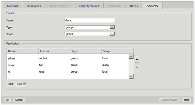

The CA 3Tera AppLogic GUI can also be used to modify an application ACL by accessing the Security tab of the application configuration dialog. As with the CLI commands, principals are referenced by their scope, type and name rather than by their principal ID. The principal scope indicates whether the principal is local or global; the principal type indicates whether the principal is a user or group; the principal name is its common human usable name. For example, the local user John is a principal with a scope of local, a type of user and a name of John. The Security tab is shown below.
In the above example, the global group deva is the ACL owner while the ACL members are global group deva with full access level rights, local group admin with control access level rights and local group all with read access level rights.
