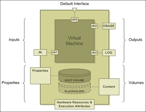

The anatomy of a typical virtual appliance
The figure above shows in more detail the anatomy of a typical virtual appliance. The boundary of the appliance consists of the following elements:
terminals, including inputs like IN and outputs such as DBASE and LOG
add-on volumes, such as the Content volume
The interior of the appliance consists of a virtual machine and a boot volume. The boot volume is configured with a suitable version of Linux, and all other software packages and scripts that are needed for the appliance to work. The virtual machine is configured to boot from the boot volume and has several virtual network interface cards.
The eth0 vNIC is always set up as a default interface, which gives you the ability to log onto the appliance, install software and troubleshoot it, the same way you would do with any remote server.
In addition, CA 3Tera AppLogic creates a separate vNIC for each terminal (input or output) defined on the boundary of the appliance. While it is possible to direct all traffic in and out of the appliance through a single vNIC, having a separate vNIC per terminal makes it easy for CA 3Tera AppLogic to shape and monitor network traffic, enforce connection protocols and improve security.
The boundary contains a set of appliance-specific properties, or parameters which you can use to configure the appliance. When you start the appliance, CA 3Tera AppLogic automatically creates an environment variable for each property and initializes it with the value that you have assigned to that property. In addition, CA 3Tera AppLogic propagates the property values into one or more of the configuration files contained on the boot volume. This makes it easy to use properties as the primary mechanism for configuring appliances.
The boundary may also contain one or more volume placeholders. A placeholder is a predefined slot for a storage volume. You fill up the slot by configuring the appliance with the name of a volume to mount. This gives you the virtual equivalent of a removable disk. Many of the appliances use this mechanism to access content such as HTML pages, custom code, or databases.
CA 3Tera AppLogic also assigns to each appliance a hardware resource budget that includes a set of three ranges that define minimum and maximum CPU use, memory use, and bandwidth use for the appliance.
Finally, CA 3Tera AppLogic associates with each appliance a set of execution attributes that affect the way the system schedules and runs the appliance. You are likely to use frequently two of those attributes - the start order value, and the migrateable flag. The start order allows you to specify and change the order in which appliances from the same application start, accounting for any dependencies among them. The migrateable flag is true by default and indicates to CA 3Tera AppLogic that it is OK to migrate this appliance from one server to another at the scheduler's discretion. Setting this flag to false will allow you to keep the appliance on a specific server.

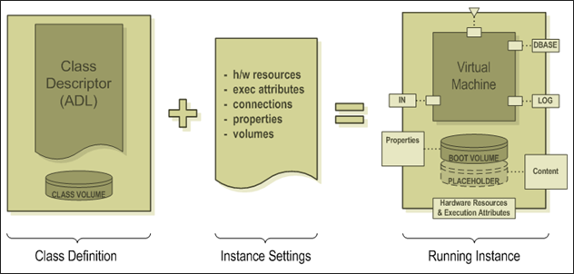

Classes and Instances
CA 3Tera AppLogic treats virtual appliances as first-class component objects. When you create a new type of appliance, what you are really creating is a class of appliances, letting CA 3Tera AppLogic know how to manufacture such appliances (they are named instances of the class) on demand. Because appliance classes are templates for making instances, they cannot be executed. An actual running application contains only instances, configured and interconnected to work together.
The process of how CA 3Tera AppLogic instantiates classes
The figure above shows how CA 3Tera AppLogic instantiates classes. Every class has an associated class descriptor, which defines:
one or more class volumes, one of which is designated as a boot volume
The complete definition of a class consists of its class descriptor and the full set of class volumes identified in the descriptor, including their content - the OS, application software and scripts which together define the behavior of the appliance.
Ordinary appliance classes can produce any number of instances. Singletons are classes that are limited to a single instance at a time. Singletons are useful when you need to edit or troubleshoot a class. Because only instances can run on the system, you always need an instance to test and troubleshoot the class. Singletons make this process simpler. They allow you to test and troubleshoot the instance, and then generate a new class automatically from the working instance.
The class definition is not sufficient to create a usable running instance. To do this, CA 3Tera AppLogic also needs to know the instance settings - a set of parameters that define how the instance is to be connected, configured and executed. The instance settings consist of specific values for hardware resources, execution attributes, terminal connections, appliance properties and names of external volumes.
To create an instance, CA 3Tera AppLogic interprets the class descriptor and creates a virtual machine with one virtual network adapter for each terminal and a virtual block device for each volume. It then creates an instance of a virtual network interface for each of the adapters and binds it to the appropriate adapter.
Next, the system creates a virtual volume instance for each volume specified in the descriptor by replicating the appropriate class volume and binds it to the corresponding block device.
The newly created instance is configured using the property values, usually by modifying the configuration files identified in the class definition and located on one or more of the instantiated volumes. Because each instance volume is a copy of the respective class volume, these modifications are private to the instance.
CA 3Tera AppLogic then starts the VM which results in booting and starting the various services configured in the appliance. It uses the hardware resources and execution attributes to control the starting, placement, scheduling and migration of the newly minted instance.
CA 3Tera AppLogic separates the configuration and connection data which is specific for each appliance instance from the information common to all appliances of a given class, including OS code, application engine code, and the configuration parameters needed to make them work together.
