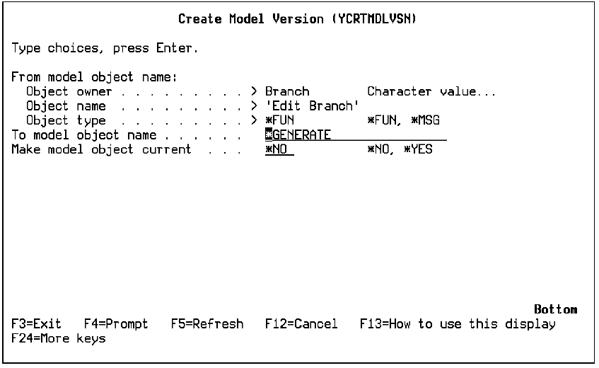

To create a version from the Work with Versions panel:
Enter selection option 3 for the version you want to use as the source for the new version. You can select any version listed; it does not need to be the current version. The following panel displays:
  1. Determine the To model object name. You can either let CA 2E generate a new name for the new version, or you can override this default.
    The name CA 2E generates is the original name suffixed by a 7-digit number; the original name is truncated if the new name is longer than 25-characters. For example,
    Note: You can define your own naming convention for automatic name generation using the exit program YOBJNAMR1C.
  2. Determine currency. You can make the new version current by specifying *YES for the Make model object current option. The default is not to make the new version current so you can edit and test the new version before you make it current.
    If you do not make the version current at this time, you can do so later using option 26 on the Work with Versions panel or by using the Redirect Model Objects (YRDRMDLOBJ) command.
  3. Determine whether to transfer the object name. You can request that CA 2E exchange the name of the original function or message with the name of the new version by entering *YES for the Transfer object name option. As a result, the name assigned to the original object will be the name indicated by the To model object name option. The default is not to exchange the names.
  4. Press Enter to create the new version and return to the Work with Versions panel.
