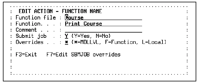

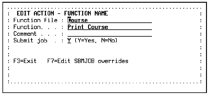

  1. Go to the location in the action diagram of the function where the SBMJOB is to be inserted and type IAF. Press Enter to display the Edit Action - Function Name window.
    Type the file and name of the function to be submitted for batch execution and press Enter. If the function you specified is an EXCEXTFUN, EXCUSRPGM, or PRTFIL function, the Submit job option appears. Type Y to indicate that the function is to be submitted for batch execution.
    Inserting a SBMJOB in an Action Diagram
    Press Enter to display the Overrides option.
    Inserting a SBMJOB in an Action Diagram (2)
    The Overrides option specifies the source of the SBMJOB parameter overrides to use for this call.
Value
Description
Model level
F
Function level
L
Action diagram (local) level
Type the appropriate value.

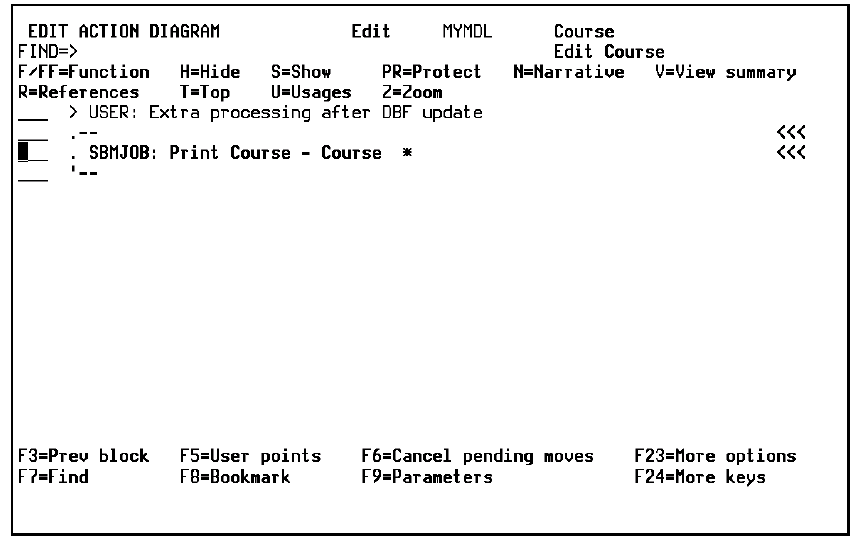

    Press Enter.
    The action diagram displays with the completed action.
    Inserting a SBMJOB in an Action Diagram (3)
    Note: The SBMJOB: prefix indicates that the referenced function will be submitted for batch execution.
