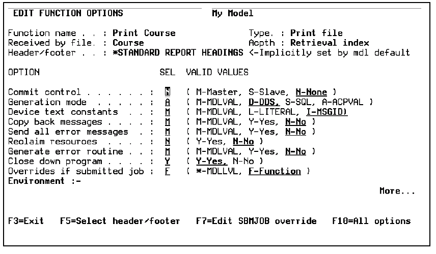

The Overrides if submitted job function option specifies the source of the SBMJOB parameter overrides and which level of overrides you are editing when you press F7. The values are:
Value |
Description |
Model level. Use the default overrides defined by the *Sbmjob default override message attached to the *Messages file in Y2USRMSG. Press F7 to edit the model level overrides. |
F |
Function level. Use the override defined for this function. You define or edit the function level default using F7 on the Edit Function Options panel. If not specified, it defaults to the model level override |
To specify a function level override, set the function option to F and press F7 to edit the SBMJOB command parameters.
Note: You also need to specify F for the Overrides option on the Edit Action - Function name window in the action diagram for the function level overrides to take affect. You can also edit the function level overrides at that point.
