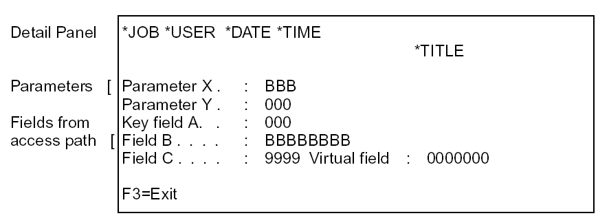

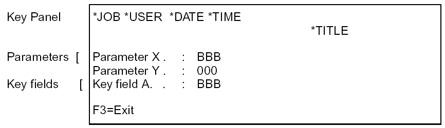

For single-record style panels (EDTRCD, DSPRCD, PMTRCD), CA 2E lays out the fields on the panel design as follows:
- Key fields from the based-on access path are placed, one field per line, on both key and detail panels.
- Non-Key fields from the based-on access path are placed, one field per line, on detail panel designs.
- When the YCUAEXT model value is set to *DEFAULT, virtual fields are placed on the same line as the real field with which they are associated. When the YCUAEXT model value is set to *CUATEXT, the virtual fields indent three spaces on the following line.
- Map function parameter fields that cannot be mapped to any existing field are placed on the display before the other fields.
