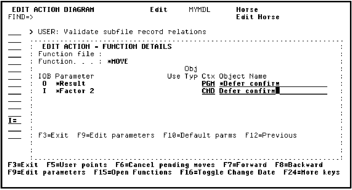

Type parameters for the *MOVE built-in function. In this case, you will type the system field *Defer confirm as the output field. Because it is a system field, the appropriate context is PGM. The input field is the Defer confirm condition. Type CND for the context. This lets you use a condition value as if it were a field value and gives you the capability of specifying a condition value as a function parameter.
Press Enter.
Your action diagram now shows the action that will suppress the confirm prompt.
