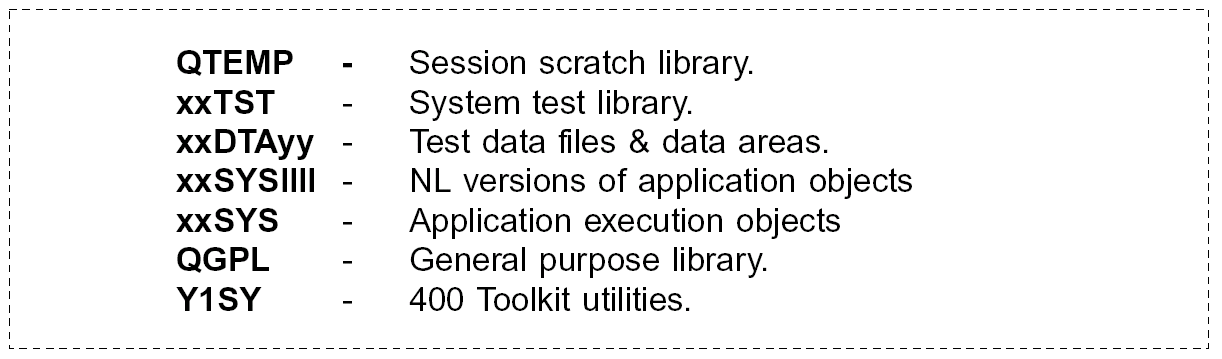

The following are examples of the library lists required to use the system described above.
Library List for a Programmer:
Library List for a Tester:
Library List for a Live User:
