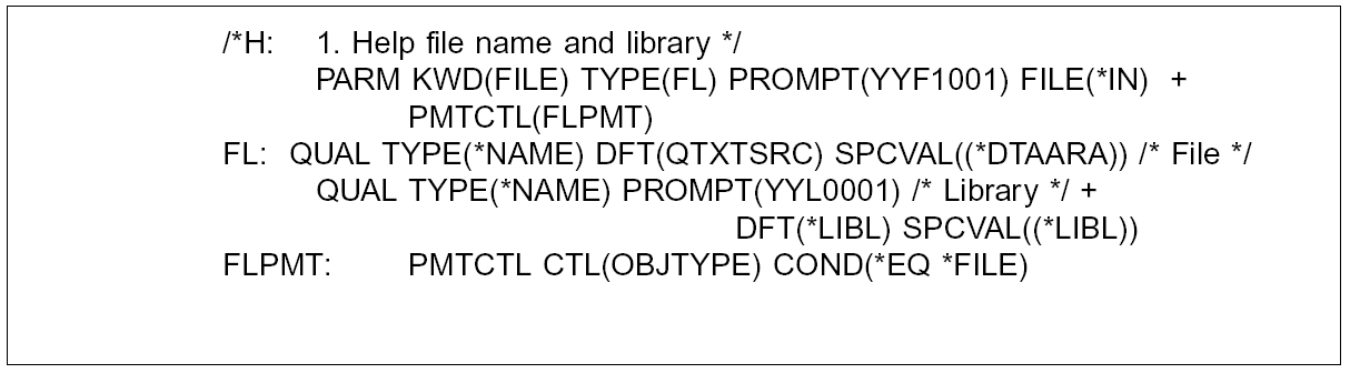

Place any ‘Element definition’ (ELEM) and ‘Qualifier definition’ (QUAL) statements to define command parameters that are lists, immediately after the first PARM statement they describe. This facilitates the copying of code from one member to another. For IBM i commands, PMTCTL statements should also be placed adjacent to the PARM statement they control.
