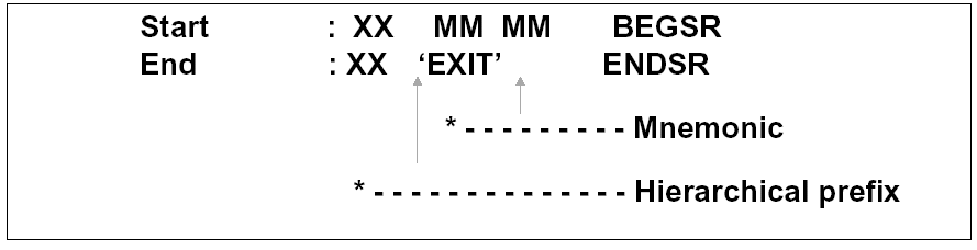

Subroutine names and label names should take the following forms:

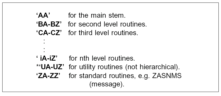

Hierarchy prefix—‘XX’ is a hierarchy level prefix, which is the same for all labels in a given subroutine, and is:

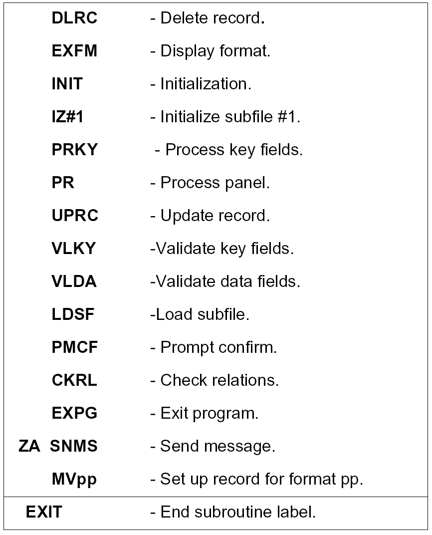

Subroutine mnemonic—MMMM is a mnemonic describing the subroutine:
The following are reserved standard subroutine mnemonics:
