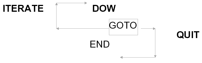

Only use a GOTO statement to branch to a point within the same subroutine. Never use a GOTO statement to branch from a subroutine to a point in the mainline code.
