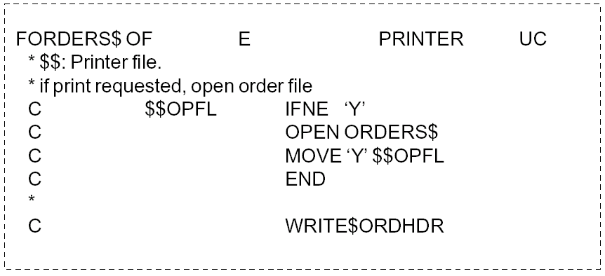

Sometimes, a program need only create a report in particular circumstances. For example, a file maintenance program might need to produce a report only if a change to the database was made. In such cases, you should make the opening of the print file explicit (use the RPG III OPEN operation code), so that unnecessary empty spool files are not created.
