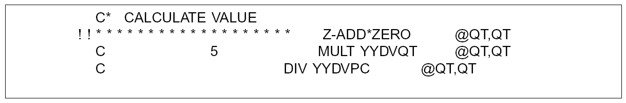

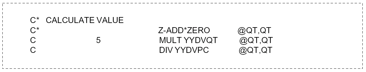

- Do not leave obsolete source lines ‘commented out’; delete them. Where you must leave an obsolete source line, use several asterisks to help highlight the fact that it is a comment line: it is easy to fail to notice that an executable source line has been made into a comment. For example, it is easy not to notice that the Z-ADD statement in the following line has been commented out:
The following would be slightly better:
