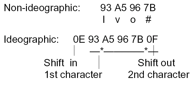

DBCS is used to represent ideographic characters. It is necessary to indicate when DBCS coding is being used in a string. This is done using two special characters—‘Shift in’ (Hex 0E) and ‘Shift out’ (Hex 0F). Characters lying between these are interpreted as being double byte.
For example, normally a string of the four hexadecimal codes 93, FA, 96, and 7B would code for four separate characters l, v, o, and #, respectively. Enclosed within the shift characters, they would be treated as two ideographic characters:
An implication for your application design is that space must be left on device files for the shift characters (one byte each), which must always be used in pairs. Furthermore, not only do DBCS characters take more space to store, but they are also physically larger on display; twice the size. However, since each character represents a whole word, fewer of them are needed.
