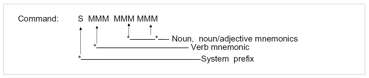

The chapter on naming conventions gives a suggested convention for commands—commands are relatively scarce and the end user may possibly see their names. Names should be meaningful and consistent with the conventions used in CL. The following is a summary of the convention:

Note the following points when naming commands:
- Names should not conflict with any existing OS/400 commands, nor with any commands that IBM may introduce into OS/400 at a future date. For this reason, a prefix letter should be used.
- Use a "verb-object syntax": the command name should consist of VERB+NOUN or VERB+ADJ+NOUN, for instance, CRTOBJ, RTVCLSRC, YCPYMNU. There should always be a verb.
- Use existing CL mnemonics wherever possible, both for verbs (for example, CRT, DSP, CPY) and for objects (for example, PGM, OBJ, DTAARA). A complete list of keywords can be found in the appendix of the Control Language Reference Manual for both machines.
