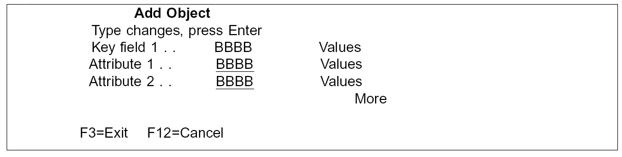

ADDOBJ (Add object). Used to add details for a new object. The details may run over several pages, with the rollup keys being used to scroll between them. The following example illustrates an Add Object panel.

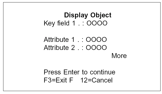

DSPOBJ (Display object). Used to display details for a given item. The details may run over several pages, with the rollup keys being used to scroll between them. The following example illustrates a Display Object panel.

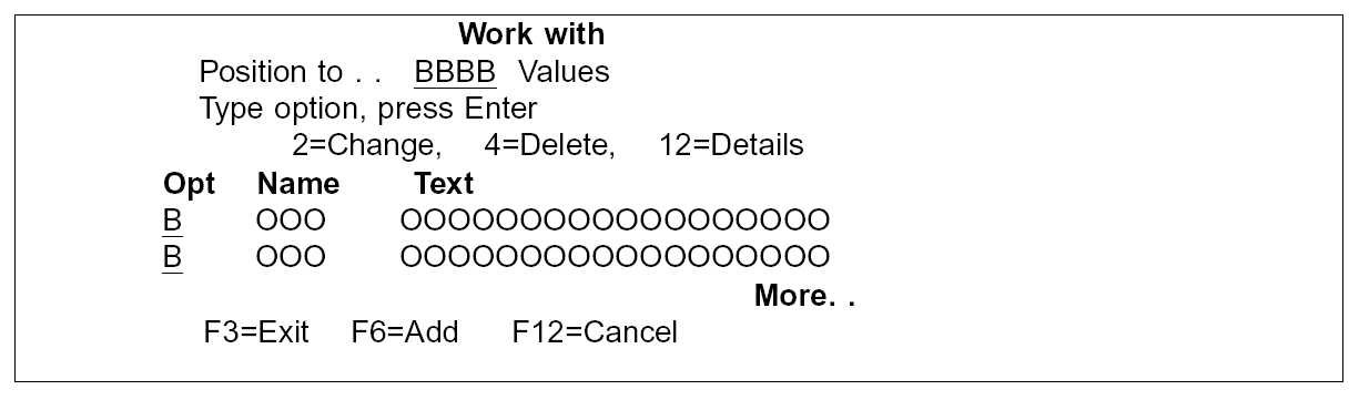

WRKOBJ (Work with). Used to work with items of a given type. Usually Change (Opt=2, shows a CHGOBJ) and Delete (Opt=4) are allowed as options. F6 can be used to add (shows an ADDOBJ for the item type). Rename (Opt=7, Shows the RNMOBJ panel) may also be enabled. The following example illustrates a Work with panel.

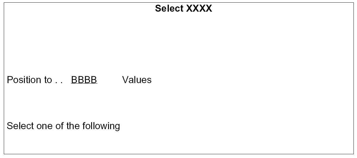

SLTOBJ (Select Object). Provides a selection display, allowing you to select an item from a list of allowed values. Always called from another pane— usually when F4 is pressed. Select (Opt=1) is the only allowed option. The following example illustrates a Select Object panel.

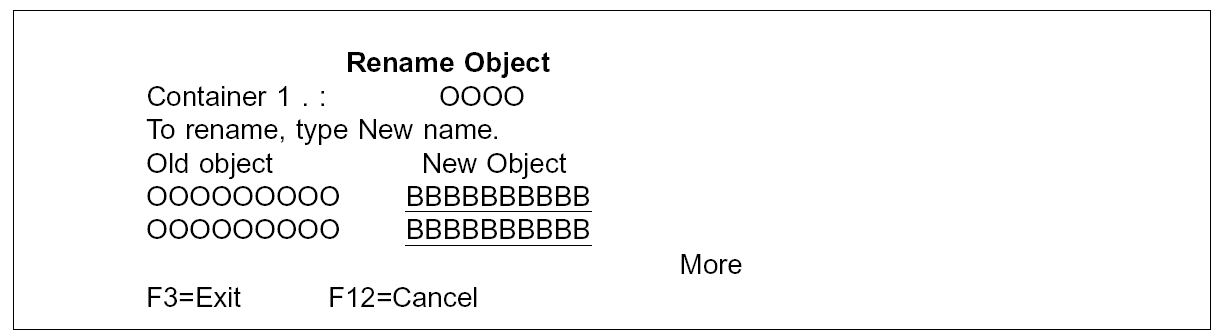

RNMOBJ (Rename object display). Used to rename the identifier of given existing items. Invoked by taking rename (Opt=7) from a Work with display. The following example illustrates a Rename Object display.
