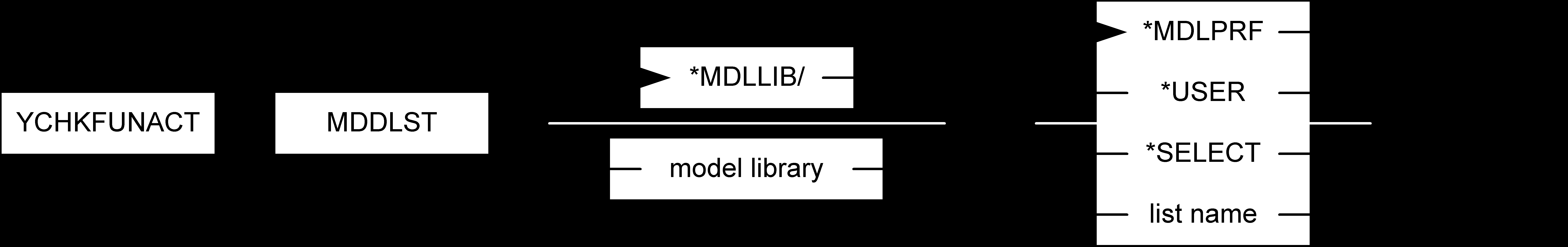

The following are parameters for the YCHKFUNACT command.
MDLLST
The qualified name of the model object list that contains the functions to be checked. Values for this parameter are described in the following:
- *MDLPRF—(default) Special value meaning that the model object list name is retrieved from the user profile extension record for the current user in the specified model library.
- *USER—Special value meaning that the user profile name of the current user is used as the list name for the target of the command.
- *SELECT—Special value indicating that the model object list is selected using an interactive display function.
- list name—The model object list name must be entered.
- *MDLLIB—(default) Special value meaning that the first model library found in the user’s current library list is used as the model library for the list.
- library name—The model library name for the list.

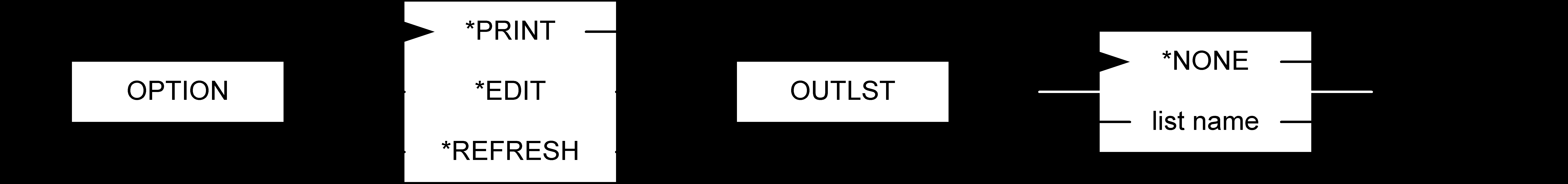

OPTION
Specifies the action to be taken if an error is found in an action diagram. Values for this parameter are described in the following:
- *PRINT—(default) The error is written to a report.
- *EDIT—The action diagram of the function that has the error is to be edited. The program will position to the first offending action diagram block to allow the user to correct the problem.
- *REFRESH—The title of each action element of the action diagram is examined. If the title is out of date, for example because the referenced function or message (or field, in the case of built-in functions) has been renamed, it is refreshed.
OUTLST
The name of the model object list that receives output from the command. Values for this parameter are described in the following:
- *NONE—(default) Special value meaning that no outlist processing is to be performed.
- list name—The model object list name is to be used as output.
