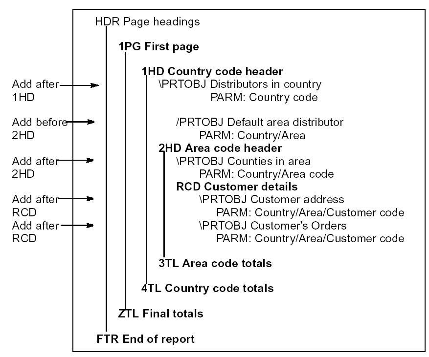

Having created all of the separate PRTOBJ functions as described previously, you would then insert them, using the device structure editor, into the basic default structure of the PRTFIL function. The following illustration shows the device structure editor with inserted PRTOBJs and the parameters specified for each PRTOBJ.
Note: In the actual device structure editor, parameters are not shown.
