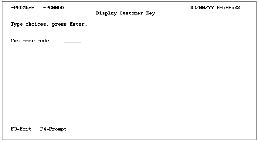

The following is an example of Key panel.
DSPRCD2 Device Function

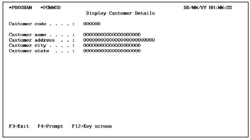

The following is an example of Detail Panel 1.
DSPRCD2 Device Function (2)

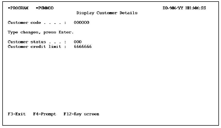

The following is an example of Detail Panel 2.
DSPRCD2 Device Function (3)
