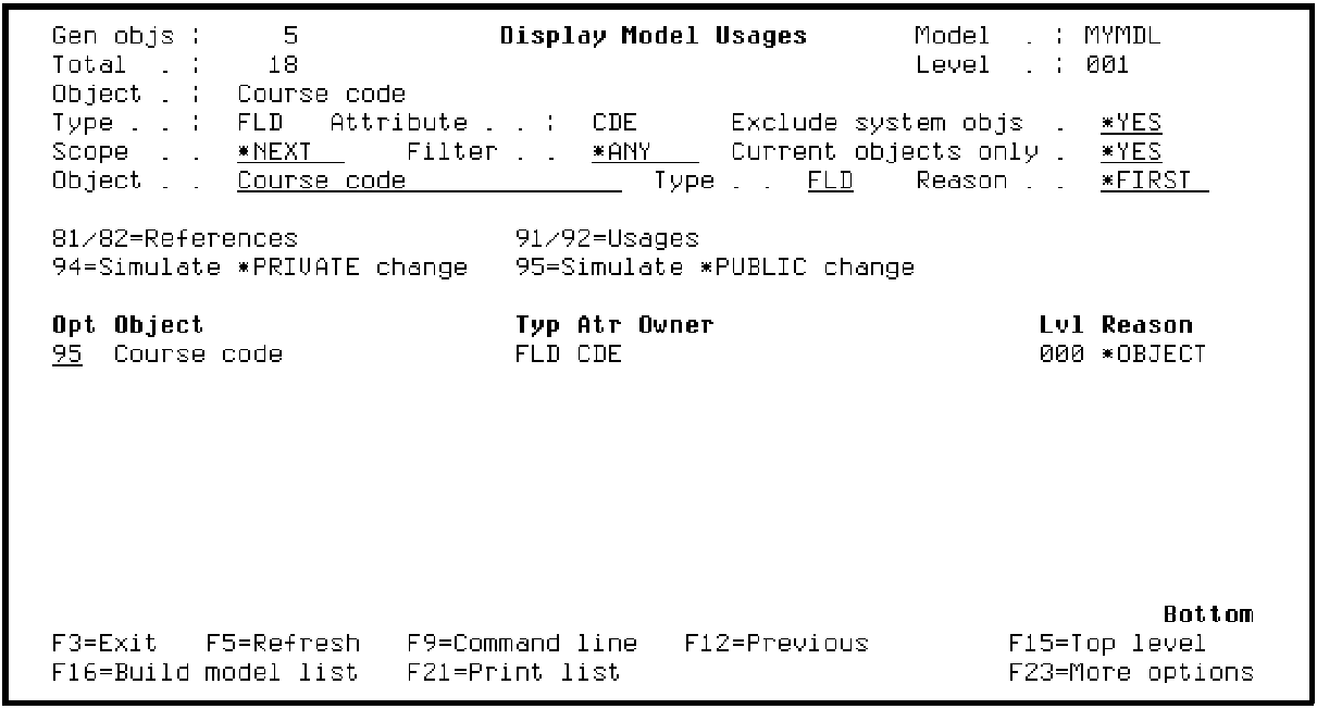

Simulating a *PUBLIC Change
Press F23 to display additional Subfile selector options. Option 95 lets you simulate a *PUBLIC change for the selected model object.
Type 95 in the Subfile selector for Course code.

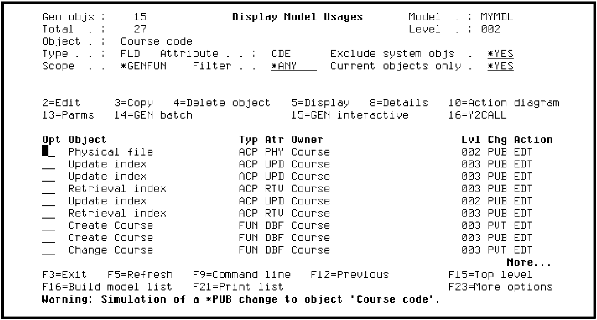

Press Enter to display all objects that will be affected by a *PUBLIC change to Course code.
