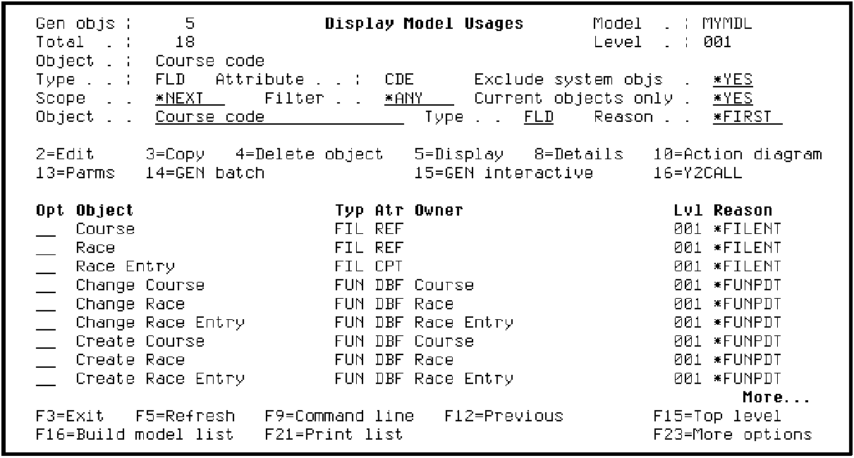

Positioning the Usages to Course Code
To simulate a change to Course code, you first need to locate it. Since Course code has many usages, an easy way to locate it is to use the positioning options. Type Course code in the Object field and type FLD in the Type field.
Press Enter.
