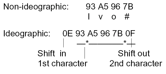

DBCS is used to represent ideographic characters. It is necessary to indicate when DBCS coding is being used in a string. This is done using two special characters—‘Shift in’ (Hex 0E) and ‘Shift out’ (Hex 0F). Characters lying between these are interpreted as being double byte.
For example, normally a string of the four hexadecimal codes 93, FA, 96, and 7B would code for four separate characters l, v, o, and #, respectively. Enclosed within the shift characters, they would be treated as two ideographic characters:
