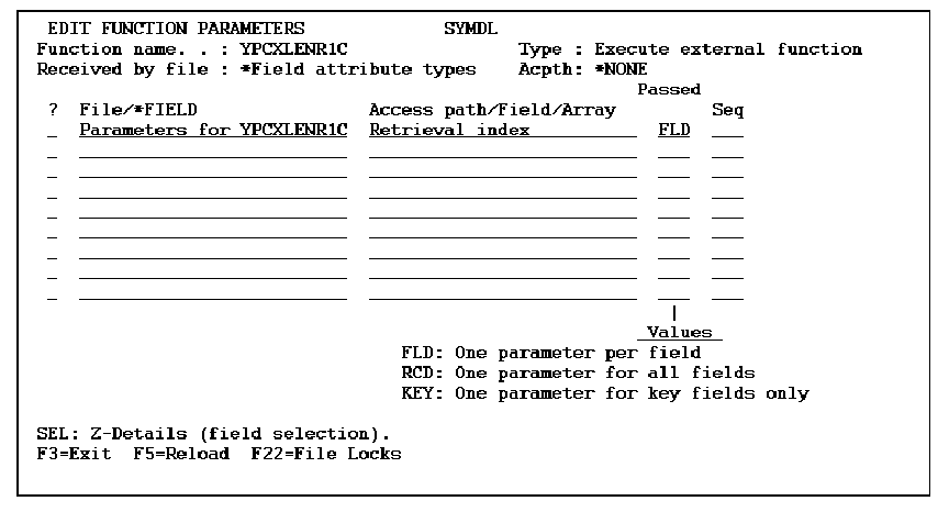

The function to perform the external field length calculation can be attached to the *Field attribute types file. Position the Edit Database Relations panel at this file and go into the functions. Add one of the correct names, in this case YPCXLENR1C, making it of type EXCEXTFUN, as below.
Zoom into the function and change the source member name to that of the desired length calculation program (YPCXLENR1C).
Attach parameters as defined by the structure file below, and give them the usage as indicated.
Attach parameters as defined by the structure file, shown below, and give the usage as indicated.
The parameters should all have a usage of I except the External length, External no. of integers and External no. of decimals. These are the parameters that the CA 2E calling function is expecting to be returned.
