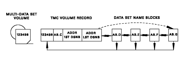

A multi-data set volume refers to a tape that contains more than one physical data set. Multiple data sets on a tape volume are often referred to as stacked data sets.
CA 1 keeps information concerning all data sets on a tape volume by using a special record, a Data Set Name Block (DSNB), for each secondary data set. The DSNBs are then chained together by pointers, as shown in the following figure. Secondary data sets are listed on the appropriate reports.
Multi-Data Set Volumes
