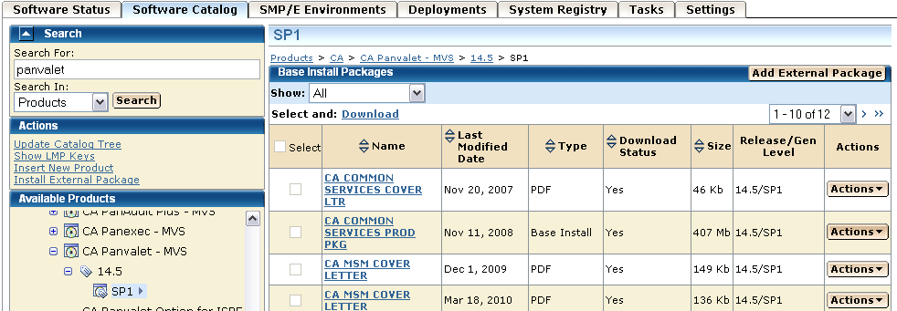

Follow these steps:
Information about the product appears in the Base Install Packages section at the right, for example:
