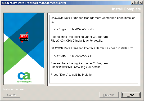

Step 11: Review Specified Installation Options
Before you invoke the installation process, review the specified installation options. If a specified option is not correct, you can correct the error before installation.
To review the specified installation options
  1. On the Pre-installation Summary dialog, review the installation options.
    The dialog displays the specified installation options.
    Note: For security reasons, specified passwords are not included.
    If you want to change an option, use the Previous button to return to the corresponding dialog to modify the specified information.
  2. When you are satisfied that all options are correct, click Install.
    The installation process starts.
    When installation is complete, the Install Complete dialog opens:
    The dialog identifies which components are installed and the location of the log files.
  3. After completing the installation, you need to start JBoss and configure the CA EEM server. You should then access the CA XCOM Management Center website, as described in the following chapter, to review the global parameters and update them, if necessary.
    Note: Although the installer has initialized many parameters, several others need to be set manually after installation.
